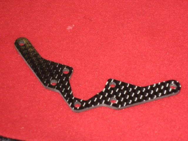

Posted September 6, 2009 chassis 2 et 2.5mm pour les lipo platine medium Share this post Link to post Share on other sites
