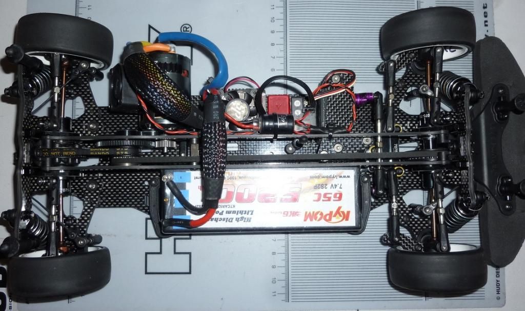

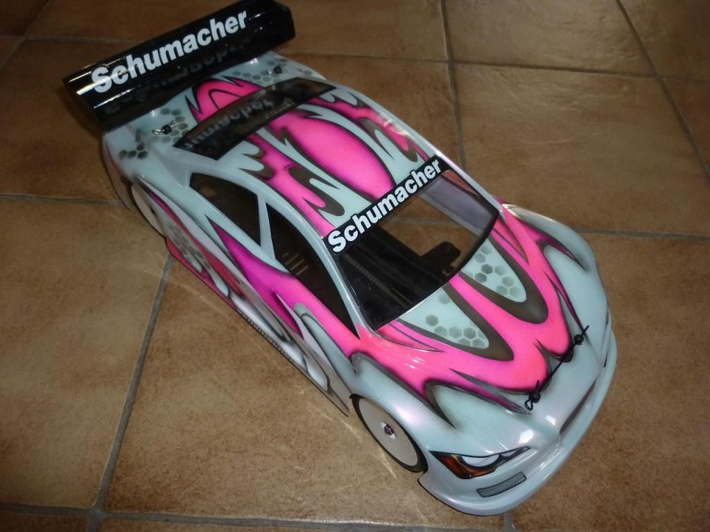

Posted June 26, 2014 Salut les gens Voila mon bestiau Share this post Link to post Share on other sites
Posted June 26, 2014 Joli Ca tourne bien moi j'en suis pas deçu Share this post Link to post Share on other sites

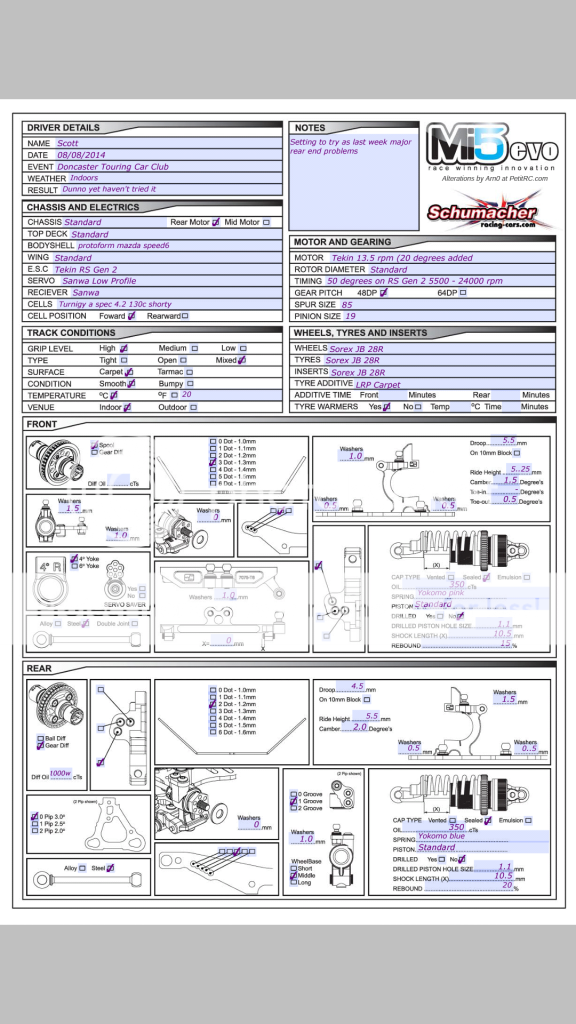

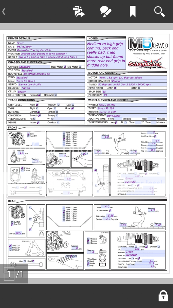

Posted August 17, 2014 et so on parlais reglages Hey all, does any 1 else run indoors on carpet that has tired the mid motor on the evo ? as struggling with it in rear motor compared to the mi5, I can do the lap times I am just on the ragged edge, compared to the ease of the mi5. I wanted to try all setups b4 changing to mid motor but it is proving difficult. we run jb 28 on carpet with med to high coming grip, 13.5 motor boosted, rear end it the biggest issue on breaks change of direction and sweepers, Ok, a few suggestions; Bodyshell - Give the normal Speed6 a try. That's the "goto" shell for carpet racing, and will certainly help to settle the car. Rear shocks - Hole 4 (one in from outside) seems to work best on the 5e. have tried going back between 3 & 4, but even in higher traction I find 4 better. Rear end setup - Personally, I think your running the rear roll-centre way too low, with no shims under the arms, and extra shims on the inner links (Bare in mind that 0.5mm shims under the balls is equivilant to a yokomo or tamiya running 0mm under their suspension blocks) I would raise the roll centre back up by going back to kit settings, coupled with the rear shock change. With the roll centre low, the car is likely to want to roll too deeply into the corner, and then dump it's grip. Hence why your probably felt like it was better in the middle shock hole, as it the shock will stiffen up more into the suspension travel the more laid down it is. Diff - Try 1000wt, as this will help to lock the rear end a little more. You will gain a little off-power steering, but loose mid & exit. It will grip the rear up basically. Rear hub plates - try the 2dink if you want the car to tighten up more in the middle of the turn. Droop - 5.5 F / 4.5 R. Unless I'm running high ride-heights (which your not) then you need to compensate in the droop settings between the two cars. The wishbone end plastics on the 5e are thinner than the 5, so you effectively need to run a higher number on the 5e, to run the same droop as the 5. In other settings, I'd also look to Yokomo Springs for carpet (Pink F Blue R), but should be able to get much closer with those above changes. HiH Ed Thanks for the reply Ed, right have dug out a mazda 6 speed shell and have done amost of the settings below but don't have to 2 dink yet, but on changing to the yokomo springs I was struggling to get below 6.5mm ride height on the rear so had to remove a bit from the bottom ball cup to get 5mm. oh and forgot to change the rear shock position on the sheet but its in hole 4, does that look ok as went back to kit settings for carpet ? Share this post Link to post Share on other sites
