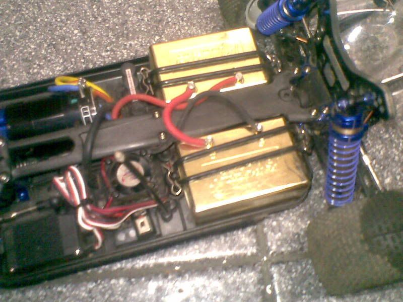

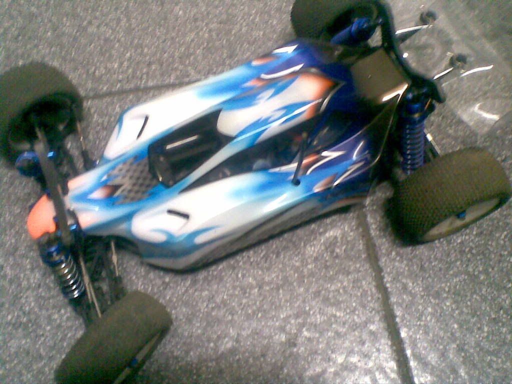

Posted August 16, 2008 Et voici mon tout nouveau FS. Vivement la coupe de France pour l'essayer. Bruno Share this post Link to post Share on other sites
Posted August 16, 2008 sympa ton FS Hobie! merci aussi à Reporter pour ces photos et infos, toujours au top ! Share this post Link to post Share on other sites
Posted August 27, 2008 Le petit Hobie a trouvé son précieeeeeeeeeeux!!! Enjoy!!!!!!!!orchestre Share this post Link to post Share on other sites

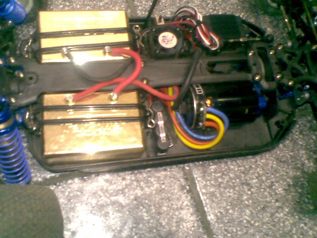

Posted September 13, 2008 ZX-5FS monté à partir d'un kit de convsersion FS (LAW38) et des pièces de ZX-5SP et les quelques modifications faites. 1. Associated Factory Team B3 turnbuckle set (4- 2.00" and 2- 1.75") 2. White Team Losi HD Ball ends and standard sized Ball Studs. 3. Associated Factory Team servo mounts. 4. Xtreme Racing Carbon Fiber shock towers. Also, because I used the longer Losi HD ball ends I had to flip around front shock tower brace so the shocks would have plenty of clearance from the turnbuckle and HD ball end. The front shocks are straight up and down now and not leaning back, I don't think it will effect the handling. Les images trop grandes (sup à 1200 pxl de large) ont été sauvegardées dans la galerie dant l'unique but de les redimensionner. Share this post Link to post Share on other sites
