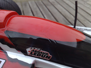

Posted January 23, 2009 Image: Arnaud Ledun, pilote officiel SMS Share this post Link to post Share on other sites
Posted January 25, 2009 Image: Arnaud Ledun, pilote officiel SMS Share this post Link to post Share on other sites

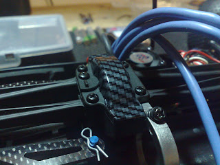

Posted January 29, 2009 Kit de visserie titane, Ref: BM-ASST Une installation électronique propre Share this post Link to post Share on other sites

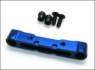

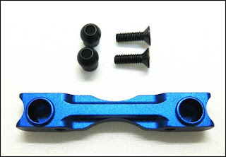

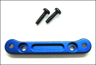

Posted January 30, 2009 BM-CP - Champion Pack Aluminum Front Shock ×2 Aluminum Rear Shock ×2 Front Titanium Coat Shock Shaft ×2 Rear Titanium Coat Shock Shaft ×2 39mm Titanium Turn Buckle ×7 Turn Buckle Wrench ×1 King Pin Collar ×4 3×12mm Button Head Screw ×4 1.0, 1.1, 1.2, 1.3, 1.4mm Rear Sway Bar Set ×1 Front Wheel Hub ×2 BM-011F - Alminum Front Wheel Hub (comapatible Associated et Losi) Front Wheel Hub ×2 Wheel Hub Pin ×2 BM-1L - Aluminum Rear Shock Set Shock Cap ×2 2×5mm BH Tapping Screw ×2 Diam 10mm O Ring ×2 Shock Body ×2 Adjust Nut ×2 diam 12mm O Ring ×2 Titanium Coating Shock Shaft ×2 Piston ×2 2mm E Ring ×4 E Clip ×2 Black Shim ×2 White thick Shim ×2 White thin Shim ×2 Diam 9mm O Ring ×2 Shield Cap ×2 BM-1S - Aluminum Front Shock Set Shock Cap ×2 2×5mm BH Tapping Screw ×2 Diam 10mm O Ring ×2 Shock Body ×2 Adjust Nut ×2 diam 12mm O Ring ×2 Titanium Coating Shock Shaft ×2 Piston ×2 2mm E Ring ×4 E Clip ×2 Black Shim ×2 White thick Shim ×2 White thin Shim ×2 Diam 9mm O Ring ×2 Shield Cap ×2 BM-200L - Alminum Servo Saver Mount BM-202R - Aluminum Center Link BM-300FB - Special Front Brace BM-300FR - Aluminum Front Suspention Mount ® Aluminum Suspention Mount ×2 3×8mm BH Screw ×4 BM-300RF - Aluminum Rear Suspention Mount (F) Aluminum Rear Suspention Mount (F) ×1 Suspention Arm Pin Ball ×2 BM-300RR3 - Aluminum Rear Suspention Mount (R3) Aluminum Rear Suspention Mount (R3) ×1 Suspention Arm Pin Ball ×2 BM-304SS - Special Motor Mount Set Motor Mount Base ×1 Motor Cam ×1 Motor Holder ×1 BM-412 - Stabilizer Set (1.0/1.1/1.2/1.3/1.4mm) Stabiliser Wire ×1 Aluminum Rod End Ball ×2 Rod End Plastic Parts A ×2 Rod End Plastic Parts B ×2 3×10mm Set Screw ×2 3×4mm Set Screw ×2 3×3mm Set Screw ×2 BM-415R0 - Aluminum Rear Hub Carrier BM-501S - Special Diff Joint(Light Weight) Diff Joint R ×1 Diff Joint L ×1 BM-ASST - Titanium 3mm Screw Set Button Head Tapping Screw 3×8mm ×4 3×10mm ×10 3×12mm ×20 3×15mm ×8 3×25mm ×2 Flat Head Tapping Screw 3×8mm ×16 3×10mm ×10 3×12mm ×2 Button Head Screw 3×6mm ×2 3×8mm ×2 3×12mm ×1 3×15mm ×2 3×20mm ×1 Flat Head Screw 3×8mm ×3 BM-SG81 - 81T Spur Gear (48pitch) ZC-S120S - Stainless Spacer Shim 12.0mm 0.1mm Stainress Spacer ×10 0.2mm Stainress Spacer ×10 Share this post Link to post Share on other sites

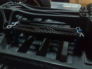

Posted February 12, 2009 Quelques photos de mon Yok fraichement monté : Share this post Link to post Share on other sites
