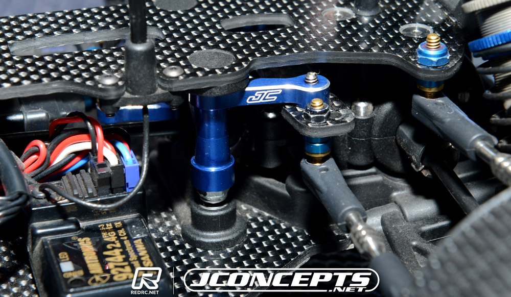

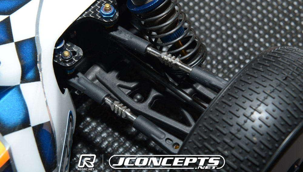

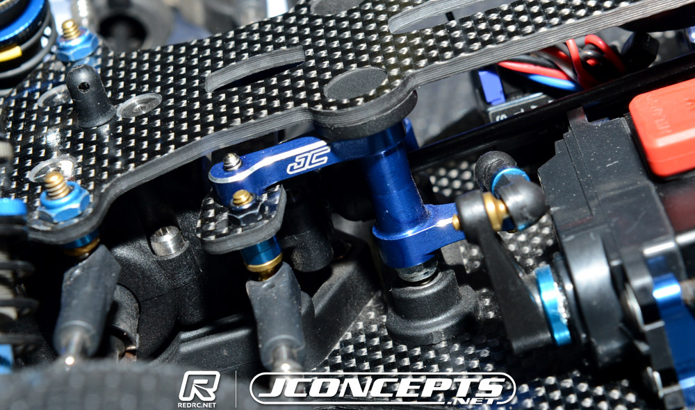

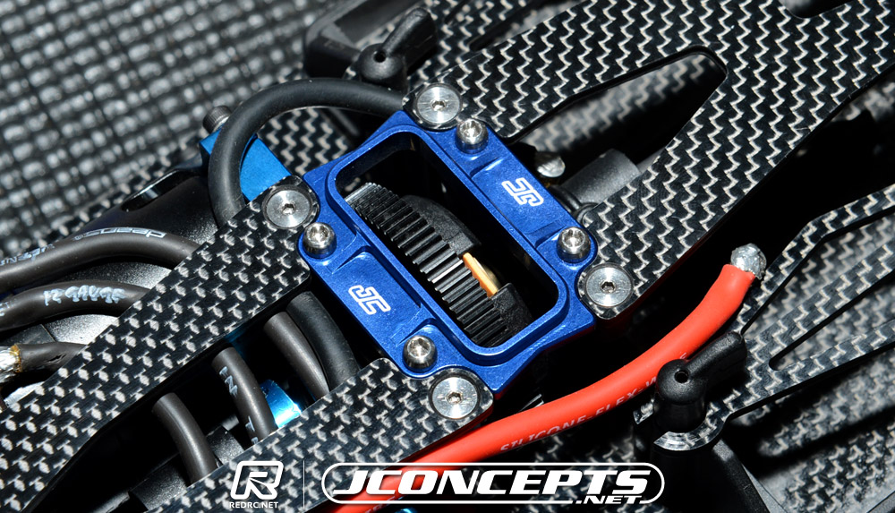

Posted February 9, 2013 des pièces jconcepts a venir pour le b44.2 Share this post Link to post Share on other sites
